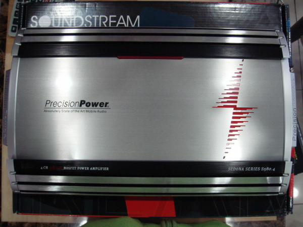

PPI S580.4    ( 미드 스피커 트윗 하데스 , 리어 스피커 미드만 )
Sedona Series 4-Channel Class A/B Car Amplifier
RMS Power Rating:
4 ohms: 100 watts x 4 chan.
2 ohms: 145 watts x 4 chan.
Bridged, 4 ohms: 290 watts x 2 chan.
PWM MOSFET power supply
Variable Bass Boost (0, 6, 12 dB at 50 Hz)
IDI Intelligent Distress Indicator for thermal, short, and impedance protection
Brushed aluminum finish
Platinum 4 AWG power block
Infinitely variable crossovers with multipliers (high/low/band)
Turn on/off delay
Tri Mode capable
High and low inputs
Variable high-pass filter (50-4000 Hz, 1/2 chan.)(15-500Hz, 3/4 chan.) @ 12 dB/octave
Variable low-pass filter (50-4000 Hz, 12 dB/octave)
Frequency response: 10-39,000 Hz
Stereo separation: 47dB
Signal-to-noise ratio: 100dB
Damping factor: 163
Total harmonic distortion: 0.03%
Input sensitivity: 0.2V-6V
Fuse: 30A x 2
Dimensions: 15-3/4L x 9-1/2W x 2-1/3H
8-gauge power and ground wiring is required for installation. Contact us for information regarding a discount on select amplifier kits when purchased together with this amplifier.
1-year Manufacturer's warranty

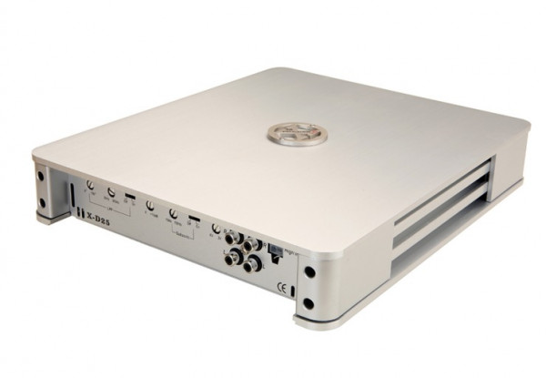

DLS X - D25  ( 2채널 HADES JM-12 우퍼 밀고 있음 )
Amplifier class D
Number of channels 2
Output power in 4 ohm 2 x 180 W RMS
Output power in 2 ohm 2 x 280 W RMS
Mono bridge mode 4 ohm 550 W RMS
S/N ratio, A-weighted > 100 dB
Damping factor > 100
Frequency range 10 Hz - 35 kHz
Input impedance 33 kohm
Input impedance, high level 1 kohm
High level input with auto start 1
Low level output 1
Input sensitivity 0,3 - 6V
Phase control for subwoofers 0 - 180 degress cont. variable
High pass filter 15 - 150 Hz
Low pass filter 50 - 500 Hz
Bass boost 0 - + 18 dB
Voltage 12 - 15 VDC
Fuses 2 x 25A
Power consumption (idle) 1,6 A
Power consumption (max) 50 A
Dimension (W x D x H) 50 x 298 x 250 mm ( 2 x 11,8 x 10")
Weight 3,5 kG / 7,7 lb
Finish / colour Silver

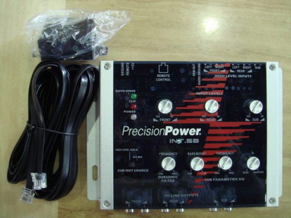

PPI INT-5B 링크
Features:
5-Channel OEM Integration Bass Processor
Subwoofer input selector
Subwoofer gain control remote included
Front, rear and sub low level outputs
Delayed remote turn on output
On-board clip indicator
Signal sense auto turn on
Variable boost Q
Specifications:
Maximum input level: 15V RMS
Maximum output level: 13.5V peak
Frequency response: 10-100,000 Hz
Siganl-to-noise ratio: 130dB
Balanced input noise rejection: >60dB
Input sensitivity: 4V-30V
Bass EQ: 30-80 Hz
Bass boost: 0-12dB
Subsonic filter: 15-50 Hz
Authorized Internet Dealer
Warranty: 1 Year Manufacturer warranty.
This item is accompanied by a manufacturer's warranty. If it is found to be defective, it may be returned to OnlineCarstereo.com for replacement within 30 days from the original date of purchase with proper return authorization. After the 30 day time period, products must be returned to their original manufacturer for the remainder of the manufacturer's warranty period.
