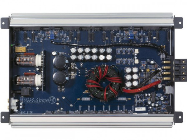

USAMPS TU-600 스펙
Two Channel Class A Amplifier
 Direct Tube Input
 Oversized MOSFET Power Supply
 Total Power Output:  600 Watts RMS
 THD at Rated Power:  <0.05%
 Signal/Noise Ratio:  >100dBA
 Frequency Response:  15Hz-50KHz +/-0dB
 Fuse Rating:  60 Amps
 Dimensions: (Including Terminals)
62mm /  2.44in   High
229mm /  9.0in   Wide
368mm /  14.50in   Long
 Weight: 3.63kg / 8.00lb
 Two Ohm Stable
 150 Watts x 2 into 4 Ohms
 300 Watts x 2 into 2 Ohms
